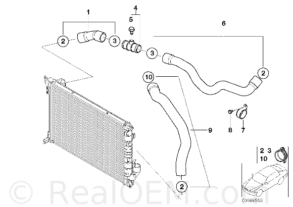

    If the repair shop wasn't knowledgeable about MINI's they may not know there is a bleed valve that needs to "Burp" the air out of the high spot in the radiator hose...
    It's pretty easy for you to do... The bleed screw is #5
