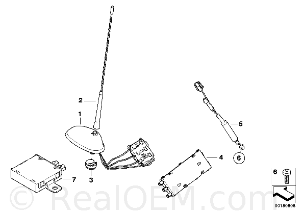

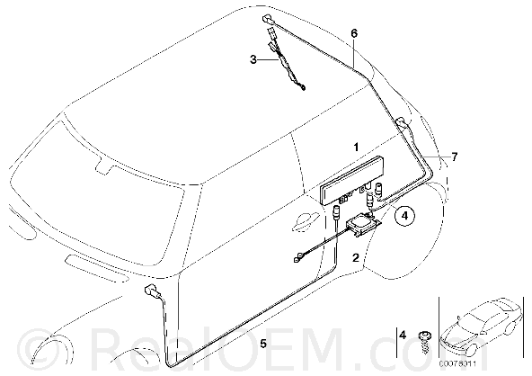

    Did you look at the amplified “diversity” antenna module? Number 1 in the first diagram.The radio MINI used in the R50/52/53 is very similar to the 99-05 BMW E46 radio. Which has the same AM static issue and to fix that you either clean all the connectors or replace the diversity antenna module.

    Also the diversity antenna system on mini's (I'm 99% sure) started with the "refresh cars"...so 2005+. you can look up the right schematics by date at realoem.com...the secondary antenna is imbedded in the glass....

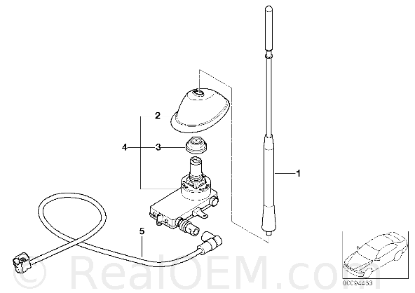

    Also the MINI DOES use a inline signal amplifier in the antenna...power is injected at the back of the radio...this is why a special adapter is needed when you go aftermarket.....like any electrical item....this could have failed.

    Both pre refresh and refresh cars have diversity antennas. Production spilt of 07/04 Part#4 is for refresh cars. Just installed a oem shortie on my friend's R53 and it has great AM reception so far.
