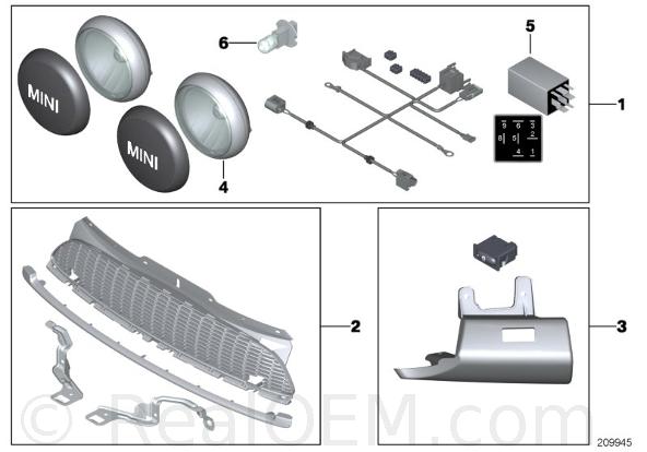

    My recently purchased 2008 MC Clubman S has a small button on the dash located just to the right of the AC vent on drivers side. It has a symbol which sort of resembles a headlight with an S or a 2 in it and when I push it can't tell if anything happens other than a small green light on the button itself lights. Cannot find it in owners manual and don't know what it does. Can anyone help? Thanks!
  2. Metalman
    12,731
    7,688
    +7,960 / 1 / -0
    Factory accessory fog / driving light switch.....
    Like #3?

    I thought that but they don't come on. Possibly a fuse?
    and yes it does look like #3!

    They only turn on if the hi-beam headlights are on.

    That did it
    Worked on high beam. Thanks!!!!:wink:
