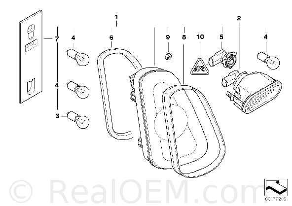

    The OEM clear taillights have bulbs soldered into the panel. MINI only sells the 3-bulb panel as replacement. I think it might be a legal issue, to prevent customers from using clear bulbs as replacement. The OEM bulbs light up red and amber (silvered so they won't show through the lens when unlit).
    Your options are to unsolder it yourself or get the 3-bulb panel.
    Here's the listing for the OEM clear tails: http://realoem.com/bmw/showparts.do?model=RE33&mospid=48021&btnr=63_0735&hg=63&fg=95
