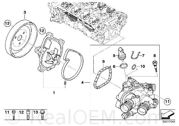

    On the R53, the thermostat and the thermostat housing (which looks like a much smaller version of what you linked to) are separate components. In the R53, you can replace the thermostat without replacing the housing.
  7. agranger
    1,483
    +1,863 / 2 / -0
    Hmmm... looks like the R56 is all one piece:
    I don't know if they go bad, but there is a temp sensor in that pic... #5
    RealOEM.com * BMW R56 Cooper Waterpump - Thermostat
    I watched a local club member replace one of these artificial hearts at a DIY day in his R56. It took him an hour or two, but it wasn't that complicated and looked very straight-forward if you are handy with a wrench.
