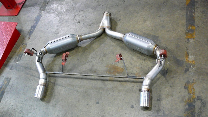

    I actually got the very last Mynes header. It is the street version. Im sure if you called, they would custom make one for you. I really love it
    RMW Race header here, lengthened O2 sensor harness, cat in the mid section and 3 hushpower cans.
    Yeah, tain't quiet....
    Some pics
    Next time it's up on the lift I'll get some of the center section.
