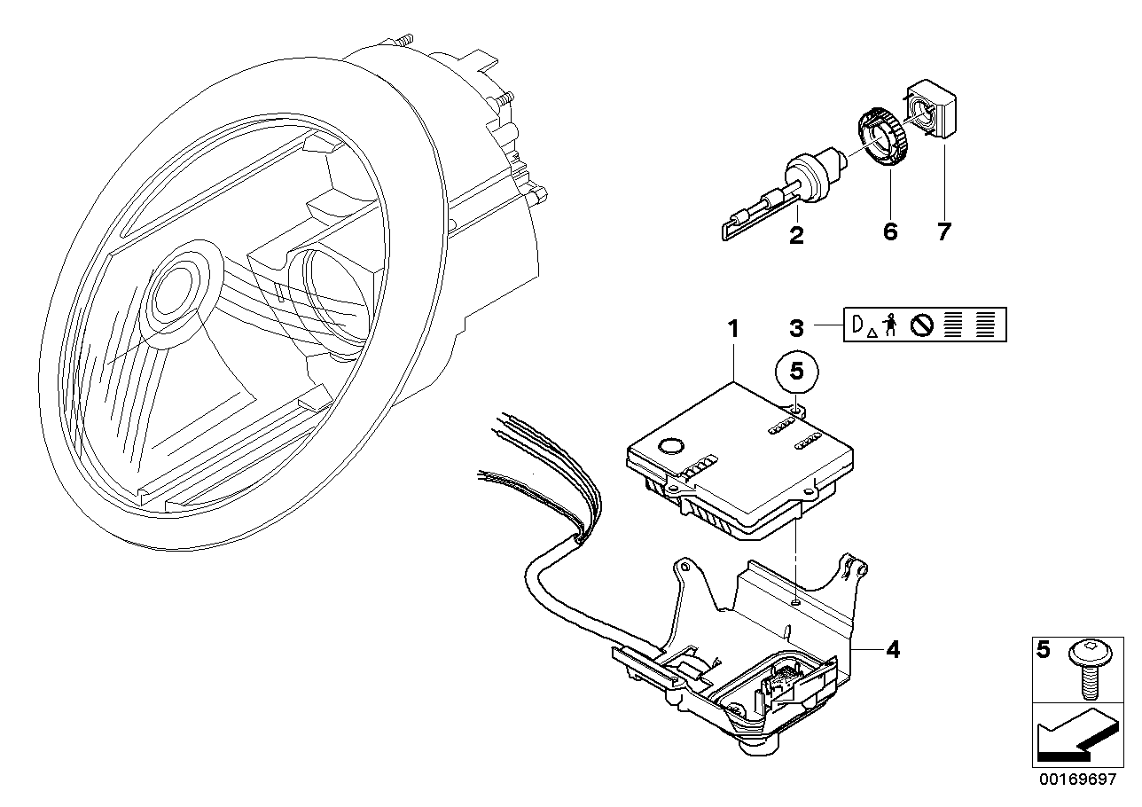

  14. Dave.0
  15. Newbie6
    Newbie6 Member
    Apr 7, 2015
    31
    +31 / 0 / -0
    Well I have an 02 and the igniter is different it looks more like this
