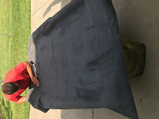

    The pleather is still up there w/ no signs of sag & looks good as new.....w/o worries wiping em clean. Got it from a local upholstery shop. Sadly, memory is failing me on cut dimensions but I remember measuring the ròof. Good luck w/ yours.:)
  20. agranger
    1,483
    +1,863 / 2 / -0
    Very nice! I broke down and paid to have this done late last week. I found a mobile service that came out and was gone just over an hour later. $175 for stock black material. $250 for sueded material.
