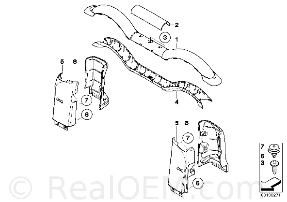

    I found this diagram. I got the center black piece off and removed the "star tip" screw (#3). But couldn't get the chrome roll bar part off. I tried to seperate parts #5 and #8, but that wasn't happening.

    Dave.O, thanks, but I believe that write up is for the R52, the R57 headrest no longer are attached to the roll bars.
