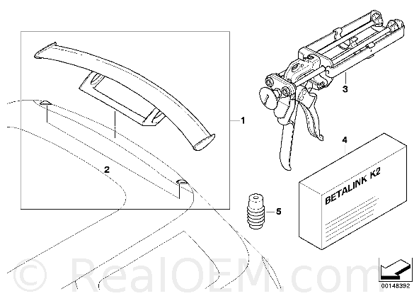

    That is a hella find, those things are as rare as hen's teeth these days.
    As you can see in this diagram the Challenge wing does not bolt on like the stock one does. There are covers for the holes where the stock one will unbolt.
    The first challenge is removing the current stock wing. Not only is it held on by 2 nuts there is some of the most stubborn double sided tape holding it too. One you remove the nuts then work under the wing with some fishing line and saw back and forth to remove.
    DO NOT try and pry it up once some of the tape has been freed. You will put a dent in the roof.
    MINI supplied a 2 part epoxy to glue the Challenge Wing on with. From MINI the epoxy and special applicator gun if still available are stupid expensive. If memory serves me well then the 3M™ Panel Bonding Adhesive is what you are looking for.
    Hope that helps.

    I hope to be of help. I have installed two of these. The adhesive gun is not necessary. At any BWM dealer or MINI dealer the Beta adhesive can be purchased in a small tube. The adhesive comes pre mixed. The kit has a spreader and adhesive remover and sand paper. As Nathan says the roof area is extremely soft and not much material so this area will be prone to dents if you pry up the old one. Use a second set of eyes for the alignment, and use a grease pencil or lead pencil to draw on the roof once you have the alignment. Sand this area first to scuff the paint. If you have a black roof, then panic! Use plenty of blue masking tape once you have the wing where you want it. let it dry and also check on the wing seeing if any adhesive has leaked out. Use the beta liquid if it does, and wipe away before it dries. This stuff is like window adhesive. 12 hours and you are good to go. For the wings to cover the old holes, I spread some adhesive on these too. Do not go through any soft touch or car wash. Mine has been on since 2008. Good luck.
