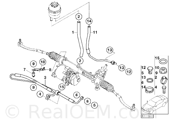

    Yeah, thats darn close to the MSRP for all the parts to do the job. You'd be pretty much replacing all these parts.
    Listing with MSRP and part #'s RealOEM.com   BMW R53 Cooper S HYDRO STEERING-OIL PIPES
