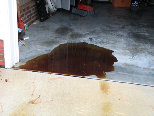

    cct1... been there, done that.
    From the way-back machine... 2007:
    I wrote a poem about it back then:
    Oh yeah... and I run a 532 on my 17%. It's definitely the right length. And it's tight.

    Oh that's nicely done!
