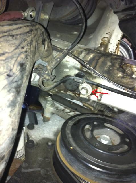

    Almost every 5-6 year old R53 I've looked at had a small amount of oil dripping from the crank sensor hole. It is directly behind the radiator fan on the engine block. Oil from there usually drips down, then is blown back across the bottom of the oil pan. There is a replaceable o-ring that seals the hole and usually wears itself flat in a few years. A $13 part and an hour or so of wrenching... I wrote a how-to article that is in the library section of this site.
    Crank Sensor Seal Replacement - Library

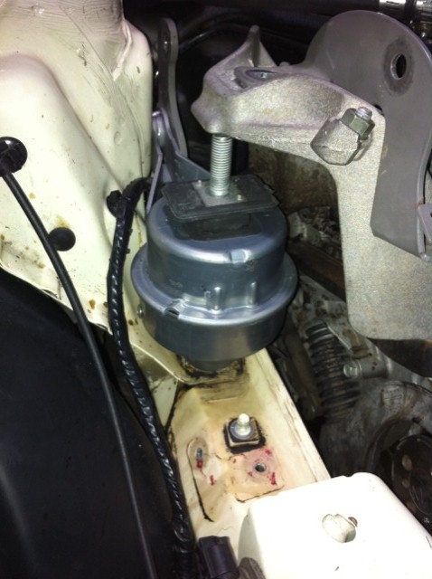

    Thick oil does suggest the damper.
    Here's a photo of one from a '06 MCS (should be the same as yours)
    The black sludge along the white frame rail is from the oil that is contained inside of the metal can. It tends to run down the frame rail (painted white in this photo with black crap in all of the edges and creases) under the damper or straight down from the damper to a spot just inside and forward of the passenger side front wheel.
    If you pull the front passenger wheel off and remove the plastic wheel well liner, you will get this view if you lay on your back and look up... you can see all of the black sludge from the damper's oil leaking down...
    I did a how-to on fixing this a few years back. I augmented my transmission mount as well, but there are instructions included on how to skip that step and just replace the engine mount.
    Powerflex Transmission Mount Bushing Install w/ Upper Engine Damper Replacement - Library
