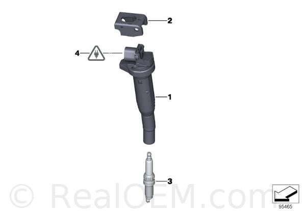

    Those are 1st Gen plug wires. You say you have an 08 R56S. Those are not going to work.
    The R56 has a coil on each plug and looks like this.

    :cornut: No they are wrong. Those are for the Pentagon/Tritec R50/52/53 engine. Correct wires for an R56 N14 Prince engine(which you have) have the coil incorporated into the wire and cost Ball Park $600. a set. Not a whole lot of those sold due to expense .:Thumbsup:

    Anyways...Will they let you return them? Stock coils are around $60 ea. How many miles do you have on your R56s?
