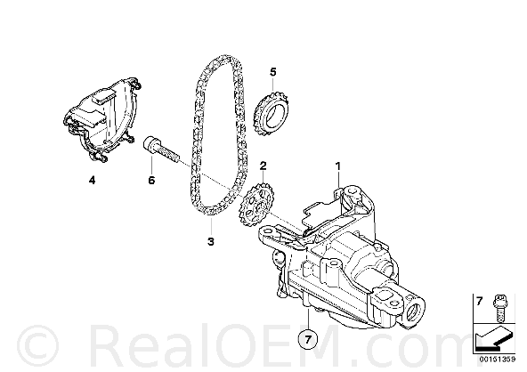

    Yah I've been struggling to find pics of the pickup. This is the best I've found and it's not a good angle or anything. You can at least see the chain and orientation. I've been trying to figure out how low it sits in the pan to figure out how much I can shorten the pan.
    What are the downsides to a chain driven one? I've never encountered one before so I don't know much about it.

    Don touched on it, what happens if you loose the chain?
    Also, it looks like the pickup is in the round section at the bottom of the pump which would tend to keep some oil pooled inside it under cornering, but I agree, not as good as an actual set of one-way baffles. That said, this pan is very easy to remove/replace and since it's made of steel, it would be very easy to fab some up.
