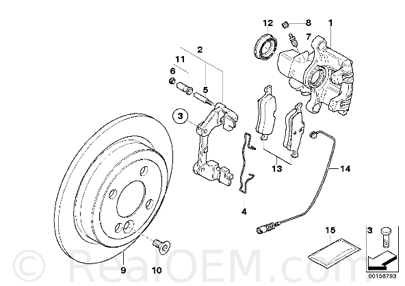

    Aren't the rears the same size?
    EDIT: Just checked realoem. Same size rotor, different looking caliper.

    Different calipers with different style pins. Different E brake cables and different wear sensors for the pads (minor)
    My guess is that it will not work. Plus the rear pads on R56 are pretty small. Slightly smaller than R53
