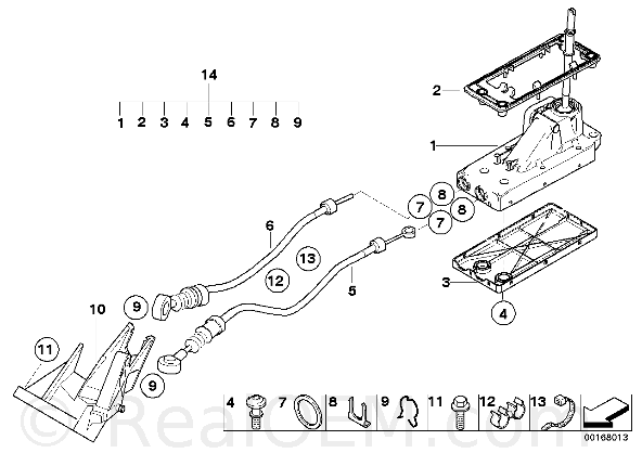

  20. Nathan
    Have a picture of the part now. You can't buy one of these according to the parts listing on RealOE<. Spoke to Chad and he's got a transmission that he has to junk, so he's going to pull the part off for me and hold on to it. I'll run up to Detroit Tuned come spring and get it installed.
    It was previously welded but the ball end came lose again.
