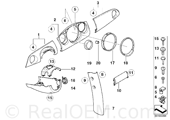

    Okay does anyone know how the speedometer trim ring on a '06 is removed? I have had success removing the AC vents next to it but all the twisting pushing and prodding nothing gives on the speedo. I keep seeing the instructions and videos saying that you have to remove the center dash and unglue it from the back. With that said the guy I bought these from told me that he just pulled them off and no it isn't a slip over ring, I checked. I watched on youtube a electronics place in Cali. showing how to remove the nav unit. Well in it they remove the dash panels and then poof the ac and the center trim rings are gone and they then just pop off the button surrounds and move on to the screws removing the dash panel. So which is it?????:mad2::mad2::mad2:

    To give you a point of reference, the center dash panel is one piece (black and painted sections together), and the speedo ring snaps onto it by friction fit. I have pictures of the speedo ring itself in my gallery: http://www.motoringalliance.com/gallery/showgallery.php/cat/586
    I've heard someone say that they had a chrome speedo ring and it was glued on. If the ring doesn't simply pull off, you'll have to remove the center dash panel piece.

    I thought once you had all that kinda loose that the big ring would rotate/spin off. Do know that with the factory cup holder sitting up that high that if you get a drink to splashing around it ends up right under that ring on the little shelf like area and will make it hard to rotate/spin..

    Yes you do need to pull the center dash section to remove the big ring. There are a few clips that need pulled up all at the same time to get it loose.
