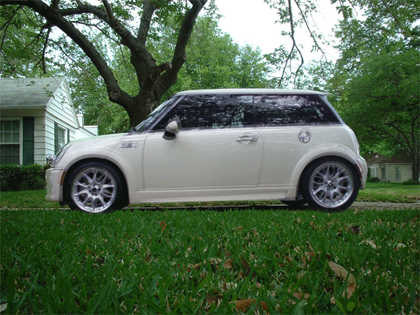

    Some pics (remember that I had the slightly lower beta test springs) are on this thread, near the end.
    New TSW Products in the werks... - Page 4 - MetroplexMINI
    I think that this is the most useful pic, an overlay of 'before' and 'after' that I did, centering the photos on the center of the wheel hubs, so you can see how much the car dropped.
    Those beta test springs noted above are now on my car with Koni Yellows and Vorschlag Camber Plates.
