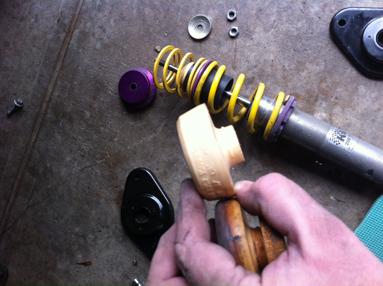

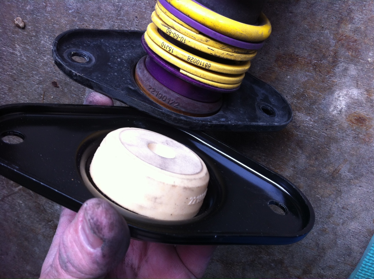

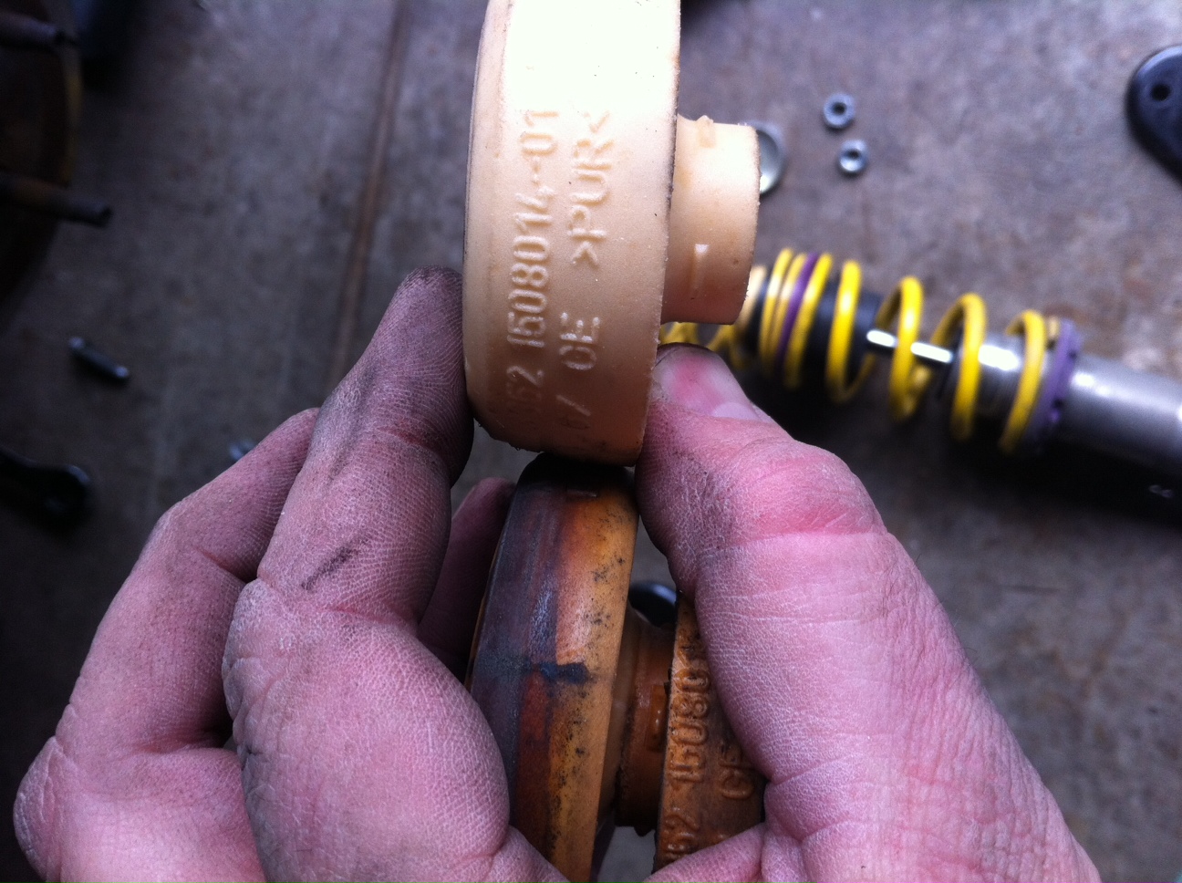

    Well... my car has been riding lower and lower in the back, so I decided to do some investigating. I remembered some rubber bushings at tne top of my upper rear strut mounts when I put on the KW V2 coil-overs a year ago, so I stopped by my local MINI dealership to pick up parts in anticipation of a replacement.
    I've got to say that I was awestruck at how compressed the old parts were!
    This is after 6+ years and 76k miles.
    If you are in replacing suspension components, I strongly recommend springing for th extra $80/side to replace these as well.

    Did these make any sounds like a squeaking or was it just the lowered ride hight you were seeing?

    Unfortunately you can't buy just the bushings... you have to buy the entire upper strut mount assembly... plates and all. That's why it is more expensive, I guess.

    No squeaking, It was just riding very low in the back. The KWs all ride low in the back, but it was so low that I couldn't get a finger between the top of the tire and the wheel well. It was really slammed. I like a lowered MINI, but I wanted a sporty lowered look, not an outrageous lowered look.

    I would have thought with that much compression of the stock bushing it would have raised the retaining nut on the shock. Seems like you should have heard a "clanking" sound made by the threaded part of the damper shaft moving in the mount??

    The rear shock shaft is subjected to high side loads because of the trailing arm position. The reason the OEM top washer on the upper strut mount is dished is to allow the shaft to tilt without causing excessive additional load on the shaft neck from resistance to the upper bushing ring. Note the stock upper spring perch (not shown) has rounded edges on the crown, this allows the edge of the perch to roll over the thicker lower bushing to some extent and provide clearance for the chassis mount. The KW upper spring perch has a wide, flat top, which overreaches the stock bushing when new, that's why the bushing was compressed fairly equally across its diameter, yet in the photo below a diagonal compression line can be seen across the side.
    If it hasn't already, the upper spring perch will eventually contact the upper mount causing hard contact and additional side-load. Look closely at the strut shaft for signs of seal scuffing along the mid section, and at the spring hat for a shinny spot where the anodizing is worn away.
    Poly bushings have less compliance and greater chance to bind before the trailing arm is at the top range of its arc. If the car is lowered, it is already at its tolerance limit. Soft is best for this bushing application. I would rather the OEM soft bushing be sacrificed over time than creating unwanted shock stiction from working against harder polyurethane.
    For aftermarket struts with with wide & flat spring hats, the AST rear upper mount is the proper mate currently available.
    The shaft sleeve within the mount keeps the nut secure on the shaft and the constant side load takes up slack from the compressed bushing.
