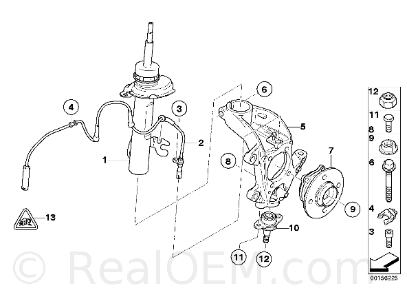

  9. Nathan
    Number 2 in the image below is the Wheel Speed Sensor. It slips into the back of the hub.
  10. Shifter
    Shifter Member
    Jun 8, 2009
    86
    24
    Southeast Michigan
    +24 / 0 / -0
    Exactly what I need. Thanks Nathan.

    Same diagram has come in handy two days in a row now!
