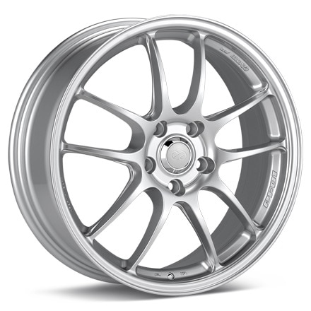

    It all depends on the quality of aftermarket rims you buy. Also make sure the wheel bolts are torqued to the correct spec.
    My rims do not have this problem at all and I have metal hub centric rings.
    Remember you get what you pay for. :idea: :ihih:
    Enkei Racing PF01's.
    Very good point & one that I knew of, but forgot because I'm a forgetful old fart.
