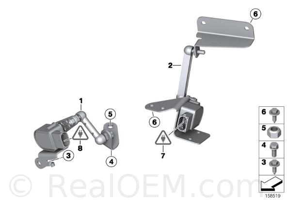

    Here in Yurp, a Mini with factory xenon lights is also fitted with ride height sensors front and back which are used to control the aim of the headlights so that the dipped beams don't glare other drivers.
    Front sensor on the left and rear on the right:
    So, do US-spec cars get these sensors? RealOEM says they do, so that would be another thing needed if anyone wanted to do a 'factory' upgrade to xenons. Plus you would need the wiring from the sensors to the lamps, which are probably not in the wiring loom of a standard-light car.

    Interesting. The US spec models do have an auto leveling feature. Good point. I never thought of that added complexity for a swap.
