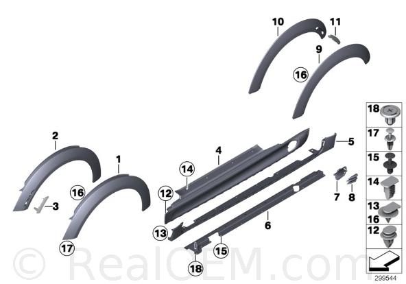

    eMINIparts.com can help you out. Buy the widgets needed. If you don't you are guaranteed to break some or all of them.
    You can pretty much just pull them off. When replacing you want new clips, the old opnes will break.
    Below is an image of the parts and clips from RealOEM

    No metal screws per say....
    At the right side of the main picture is a picture of all the fasteners used with the images depicted in the large picture area.... They are all plastic fasteners of various designs...
    The primary fasteners used to hold on the plastic arch is #16 and there is another fastener on the start of the arch which is a push rivet #17..... All circled numbers on the main picture correspond to the type of fastener....
    The best approach is to buy all of the #17 fasteners needed for one arch. You will break some when you pull the arch off. Snap the new fasteners on the new arch and align them with the metal fender holes and push in until you hear them "click" in place.
    These can be purchased directly from the dealer if you like or contact some of our vendors for an even better price and support the group that supports M/A...... Win - Win...
    The part numbers can be found here...... RealOEM.com Online BMW Parts Catalog
