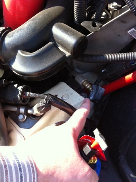

    I have a recharge kit , and wondered if it mattered which outlet I put it in to ImageUploadedByTapatalk1373558695.658635.jpg the top or bottom ?

    Use the one in the picture right. The closest to the driver.

    2,190
    Yep... use this one!

    BTW: That photo is a part of this how-to article on how to do a quick recharge:
    How to top up AC Refrigerant in an R50/53 - Library
    The other nice thing... the fittings on the high and low pressure sides of the system (you add coolant to the low pressure side) are now different, so you don't have to worry about getting the wrong one. Your coolant rig should only fit onto the one closest to the driver.
