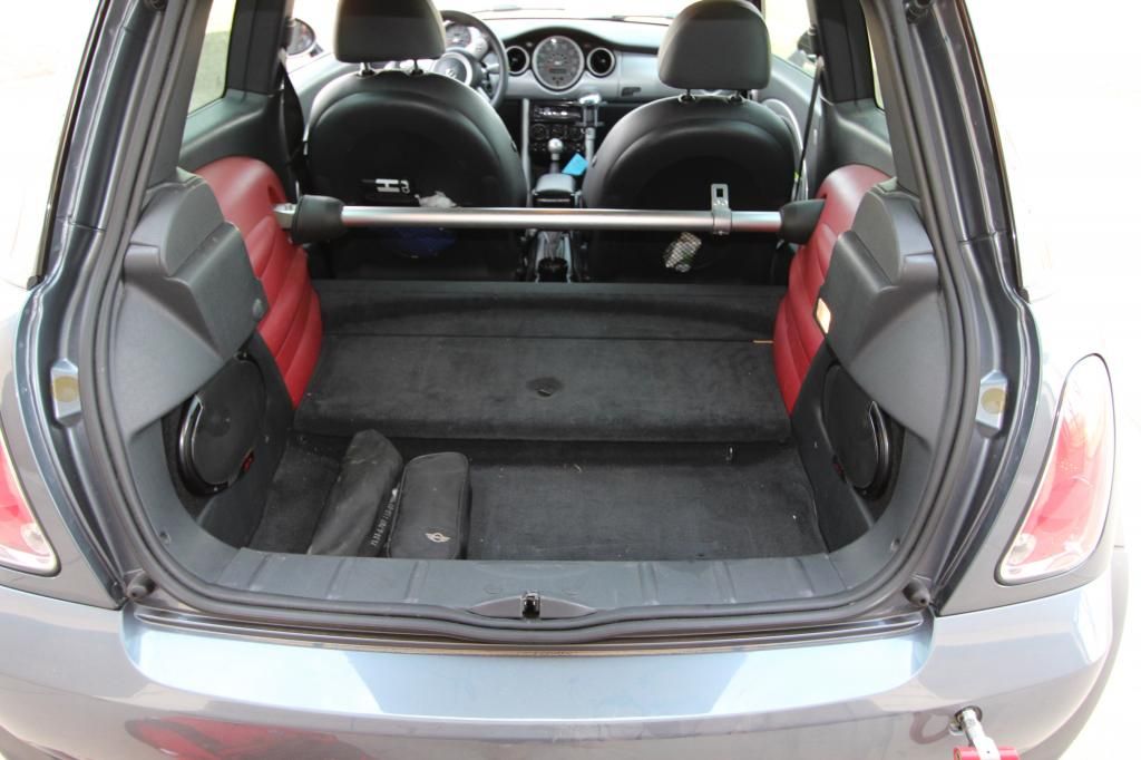

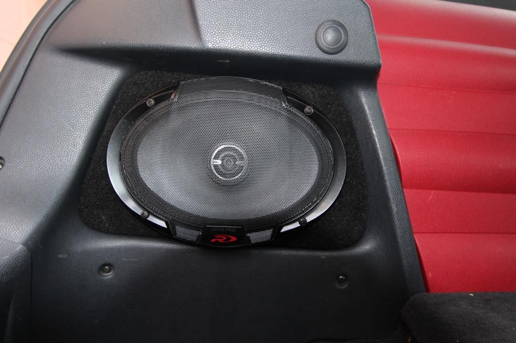

    I got a PM asking if I would put some pictures up of my installation...so here ya go!
    The head unit is an Alpine CDE-HD148BT. It does Pandora, SiriusXM, Bluetooth, and has HD radio tuning which is pretty cool. Perfect fit to replace the stock GP radio. The radio lights are orange! Btw...non Harmon Kardon radios are made by Alpine in first gen MINIs. There is an adapter kit for the radio to tie into the steering wheel radio controls. My Bluetooth mic is up near the rear view mirror. (yes...that's a peanut cup to the left of the gear shift)
    All speakers are now Alpine R Series. Front speakers are SPR-10T tweeters, with SPR-60 coaxial 2-way speakers. I kept the stock door speaker grilles to retain the GP look. In the rear are a pair of SPR-68 speakers. They are 6x8" speakers, not 6x9". If ya look at the photos of the rears you'll notice the mounting board just can't take the 6x9" but it can just fit the 6x8" speakers. And yeah, that was discovered the hard way...had 6x9 laying there, made the board to hang them and went...Oh Shitake... On the inside of the mounting board for the speaker are four pieces of thin metal that grab inside the edge where they're mounted. Like a tab sort of ...they're adjustable so you can lay the board flush and then turn the metal tabs up or down to grab inside the plastic interior . Once the board is mounted you screw the speakers up after ya wire them...and presto!
    Up under the dash is a PDX-F4 digital amp that pushes 100w at 4ohm x4.
