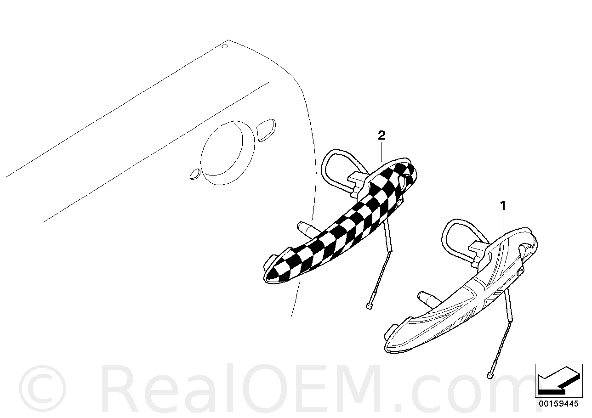

    Oh? I saw a set at work and they were the hold handle.
    I tried PD and wasn't to happy with it.
    From my reading it seems that most people are buying these or these and refinishing them.
    Took at look at the Euro version of the car on RealOEM, which, I know doesn't have everything anymore, RealOEM is slipping, but the only whole assemblies are chrome with them also showing the same checkered or Union Jack ones as an accessory.
    MINI has a black door handle from the factory available?

    Those are the PUTCO brand covers. These are the ones I'm thinking about buying and painting them Jet Black to match.
    Realoem.com is a pirated version of ETK some hacker put on the internet. It hasn't been updated since the spring of this year. BMW is actually trying to have the site closed down.
    Well I have the use of the ETK and under a Euro version there is no black covers shown under an R56 or another other model. It would have been awesome if MINI had black covers for the handles and gas cap with the Blackline kit. Yes the Union Jack, Black Jack, and Checkered handles are the whole door handle assembly.
