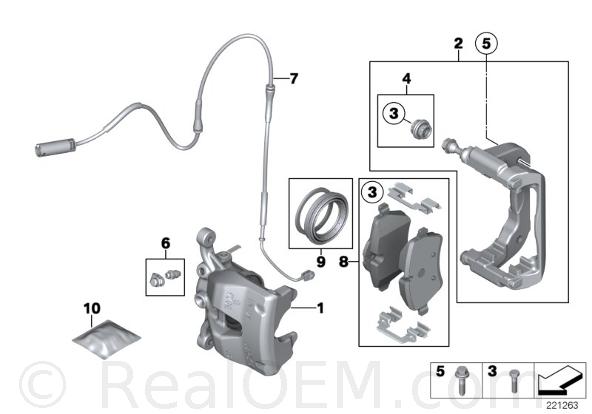

    what the... realoem lists them at $121, my dealer quoted me $245 each!:mad:
    We usually pay about 20% more in Canada, but this is ridiculous

    You must have something in error..... You won't find a new OEM brake caliper for $121....
    What P/N are you looking at?
  7. BlimeyCabrio
    Prices on RealOEM are notoriously inaccurate. Never trust them.

    If the guide pins don't have any wear or corrosion.... Why not just get new rubber sleeves? 34116768189 Item #4 Repair Kit bellows....

    You got me all excited about the repair kit, but the bellows are not what I need.
    Bellows on the left are OK, it's the rubber sleeve at the arrow that's the problem. I agree it may have reacted with the caliper grease or maybe it's just old age (5 years, 130000 km).
    btw that's the lower pin; the upper calliper pin has a straight shaft with no rubber sleeve.
