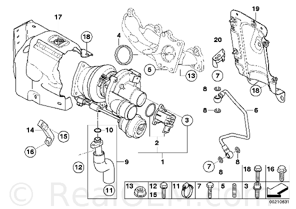

    I'll assume the burning oil smell is being drawn in through the front vents. The first thing I would look for is oil seepage at the oil connection lubricating the turbo bearing. That crimped oil line connection has a flexible gasket o ring seal. They are known to start leaking after awhile. I suspect MINI is aware of this since the came out with a heat shield that clips over the fitting (see pic). Tightening the banjo bolt won't stop the leak if the rubber seal inside the crimped fitting is the culprit. The oil line will need to be replaced..... If this is where it's leaking......
    Item #20 is the heat shield
    Item #6 is the suspect oil line.

    Thanks for the input guys. It's pretty smelly under the hood after going for a drive today. I checked the oil line and it is pretty loose at the banjo fitting where part 6 meets part 7 (lower end in the diagram). I can easily slide it in and out of the fitting - there's at least a 1/4 inch of movement. That just seems wrong - is it supposed to do that? Surprisingly, I don't see any oil around the fitting though. Maybe it burns off right away due to the turbo heat, or else the leak is somewhere else.
