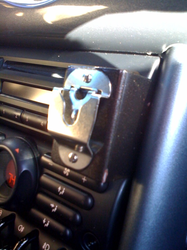

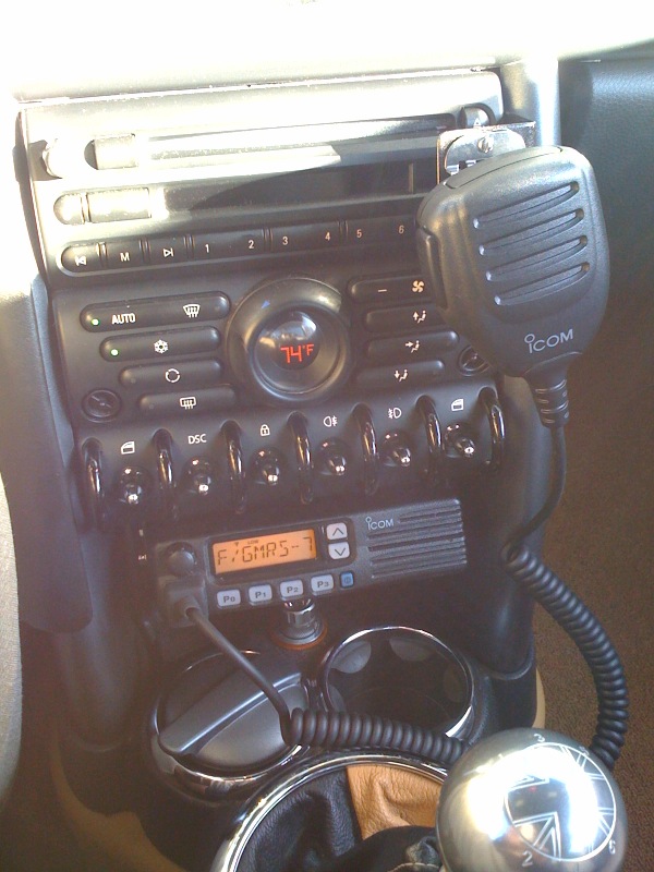

    I installed a 45 watt VHF radio (the hand-held FRS/GMRS radios are usually 2 watt) in my MINI for when I lead group drives. It doesn't have the random participation of a CB, but works great for a more controlled broadcast like for club drives and I can broadcast/recieve to the FRS/GMRS bubble-pack radios like those shown above.
    Pics and details are here: MINI COOPER :: North American Motoring - FRS/GMRS mobile repeater

    Thanks for linking that. I had pretty much figured out the ICom 221 was the way to go with it mounted in the cubby below the toggles. Can you comment on what the sound output is like? During club drives, I tend to keep my windows down, so lots of wind noise. Sometimes I use a "headphone" that goes in my ear with a mic, other times just use the radio directly (more often the case when I have a passenger).
    Can you hear the radio ok even with it mounted so low?

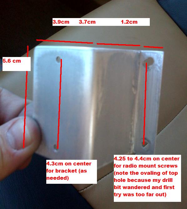

    I'm cross-posting some of the pics for the discussion:

    The volume capacity for this little radio is pretty good. The speaker projects out of the front of the unit and I usually drive windows down for club drives as well. Of course it will be easier to hear with the windows up, but the sound quality is more of a factor of the broadcasting unit with this radio than a limitation of the speaker quality/direction or volume.
    The one thing I do miss is the ability to use sub-channels. On my larger drives I don't like to use sub-channels as some folks have the cheapest of FRS handsets that don't have the sub-channel option. When you are at MOTD or some other large event where lots of people are using FRS, having your own sub-channel is nice so you are not stepping all over other conversations.
    When I was at Fontana, people up at Fontana village heard me broadcasting from the campground (base of the dam)... I couldn't hear them because their signal was too weak to cut through the trees, but someone heard me and mentioned it later at a party. On a large run that I lead every year, we split into 2 groups, a 'scenic' drive that I lead and and a 'spirited' drive that leaves 15 min later that Nathan has lead for the past several years. When I was at the top of a mountain, about 15 min (10 miles) away, Nathan's group heard me broadcasting like I was standing right next to them.
    I am loving the bracket that I made for the handset and it is still working great after 2-3 years. I think I made it from a bit of aluminum stock that I cut out of a door kickplate that I bought at Home Depot. The only thing that I would change is that I would try to set it just a tad bit lower... maybe 2-3mm is all. When I eject the CD, I have to catch it on the way out and lift the leading edge a bit so it doesn't snag on the top of the bracket. If I ever have to disassemble that downtube, I may oval out the mounting holes a bit to drop the bracket just a smidge.
