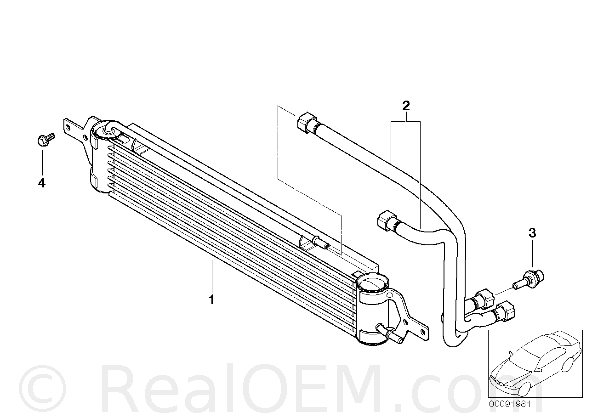

  9. Nathan
    The Cooper and S show different part #'s for the Radiator for a 1st Gen MINI. The price is the same. what differences there may be between the Justa and S radiator I have no idea.
    The CVT versions add a Transmission Oil Cooler that is in front of the radiator.
    People have used these as Oil Coolers on S models.
  10. RallyMini370
