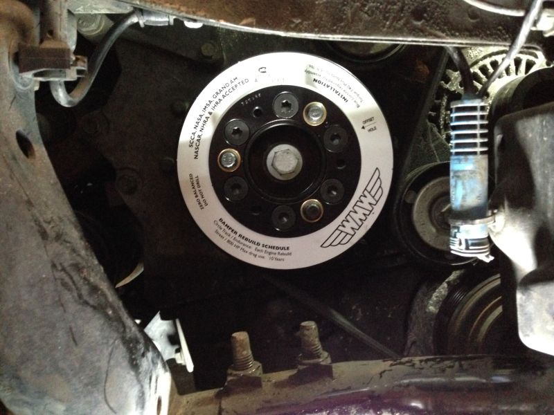

    Ok....so after a month and a half I finally got all the parts assembled and started the pulley replacement project. I went with the ATI unit, I also decided to replace the idler pulley, belt tensioner and upper engine mount as well.
    Last night I removed the pulley.....I ended up purchasing an impact wrench along with a few other tools to make the work go a little easier. I should have bought a bigger air compressor too but.......
    The pulley was in two pieces as the rubber center had completely failed. There are marks on the side of the case where the pulley was coming into contact. The oil seal appears to be in good shape as it doesn't show any signs of leaking. (Don't fix what ain't broke).
    Tomorrow I am going to finish taking off the upper mount and belt tensioner. Then it's time to "Cook" the pulley.

    Thanks for posting the DIY. I decided to tackle this while on vacation this week. Purely a preventative measure.
    I used a harbor freight puller kit and some 6mm class 10.9 bolts and some washers sourced from menards. Worked like a charm. Had a bit of interference between the puller tool and the car chassis, but that would have been resolved by using some longer bolts. I used the longest I could find (75 mm IIRC) and made it work. Heated the new pulley in the oven on 250 for about ten minutes and it went on with ease.
    One less thing to worry about blowing apart now.
