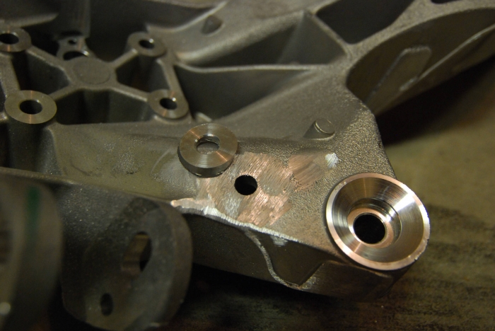

    As far as I know, the R56 trailing arms need to use R56 end links, or else you need to grind down the shoulder they mount to because the bolt/stud on R53 end links are too short.
    I'm looking to install my Hotchkis sway bar before a trailing arm conversion later this year, and want to know if end links for an R56 will work with stock, steel, R53 trailing arms. Mainly, will the longer R56 threads just stick out and not interfere with anything on the suspension, and are they threaded far enough down to tighten against R53 trailing arms. I'm trying to avoid buying R53 adjustable endlinks now, then R56 adjustable endlinks later.
    Here is a pic from the MA guide on the conversion of what needs to be done to use endlinks for an R53.

    I sell whiteline adjustable links that will work for both,
    but really you need the R56 style links for aluminum trailing arms because the boss is thicker.
    You can use the R56 links on a R53 the dealer can sell them to you as a pair at a reduced cost under a "repair kit" however i think its still around 100$
