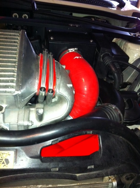

    I've got a handful of engine mods coming (plus some shiny new coil-overs), so I thought I'd make a new picture thread.

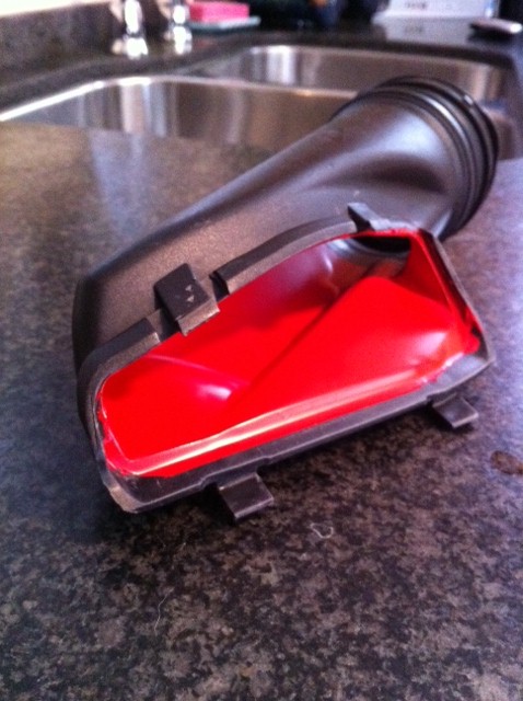

    I was searching for something on Google Images last week and I stumbled across someone who had done this mod... In my years of MINI fanboy-ism, I had never seen it before, so I had to do it... plus I need more red in the engine bay! I've been trying to find the pic so I can give proper credit, but I just can't seem to reproduce that same search.
    This mod was easy enough to do. A simple snap clamp holds the bellows of this part onto the airbox lead. Some clips hold the front of it onto the radiator surround (I already had it unmounted from a thermostat and housing replacement last weekend, which inspired me to go ahead and get this done). I washed the part carefully and sanded the surface to be painted to get good paint adhesion and to remove any plastic casting seams. I covered the whole thing in painters tape, masking it off so that only the inside was exposed, and taped the whole thing to a spare dowel that I had in the garage so I could paint it without making a mess of my hands and arms. A coat of primer and 2 top-coats later, I was almost done. It took a whole 60 seconds to reconnect the bellows and clip it into place. The nature of the mount onto the radiator surround makes for a very nice install... even if you get a bit sloppy with the masking/painting.
    Yeah... it doesn't add any power, but it does look kinda cool! I'm not above the purely cosmetic mod, as long as you don't try and claim some artificial boost (well... I did sand down one pretty rugged plastic seam... is that a port and polish? :D ) The exterior of Jango is all about minimalism. I'm a sucker for any additional red bling I can get in the engine bay.
