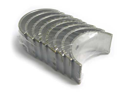

    Here is a pic of the connecting rod bearing shells.....btw, Mini Mania would be an excellent source of both info and the parts you'll need. See the hole in the center of the shell? That has to line up with a corresponding hole in the connecting rod. The crankshaft main bearings will look similar, but will be larger and wider. Also there will probably be separate thrust washers that take the sideways load incurred by pushing on the clutch. The red seal LilPig mentions is the rear crankshaft seal, and yes you should definitely replace it.
