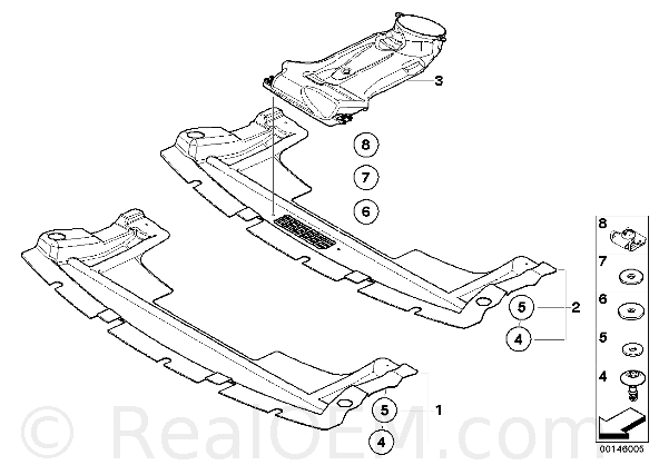

    The duct is actually open to the front of the car, so when you are moving it acts as a ram air duct. And it does a great job of keeping the debris from blocking the fan blades.
    I believe it was only on the 05' and up verts.

  19. Nathan
    The added ducting...
