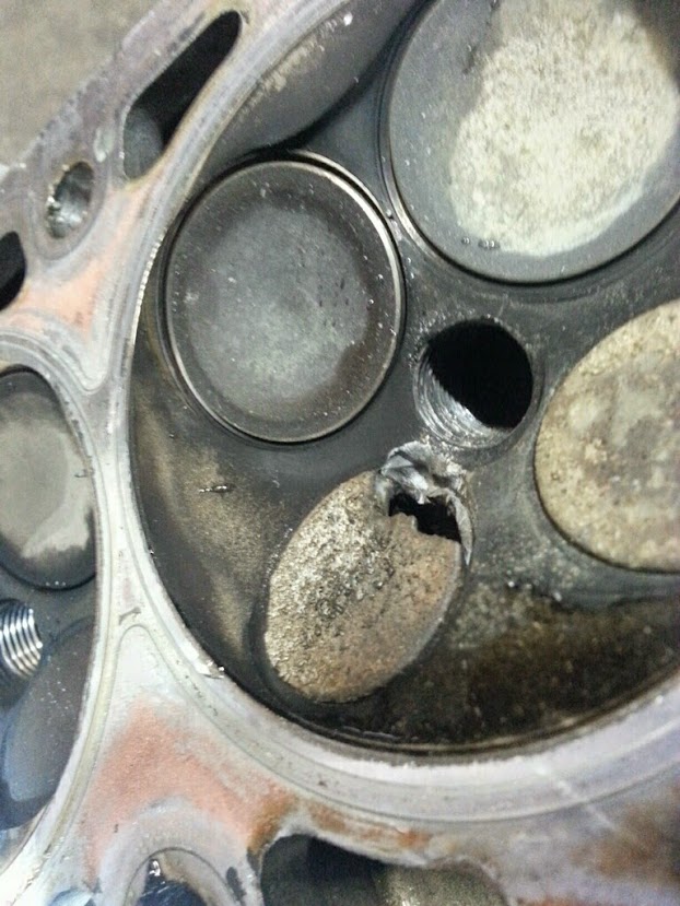

    And what ya'll have been waiting for....the carnage
    Could the O2 sensor wire being pinched give erroneous reading leading to a rich condition that was then leaned out too much not knowing the signal was not correct. There have been way too many hands in there, including my own, to point to the exact culprit.
    There are some other issues Chad found as well. A motor mount that is not functioning properly. Lots of the incorrect clips and fasteners used by the body shop. There is some interesting wiring as well.
    Now to let it all sink in and formulate a plan of action.

    Is that valve seat area fixable, or do you need a new head?
    Jesus! you probably need a new head . . . call RMW.

    Yeah the valve was badly broken, the valve seat was melted, and the head it self was melted, so there is actually a hole between the valve seat and the spark plug hole. Nate is now taking bids for this piece of history. The head will be cleaned and signed buy Nate and all mechanics that have touched it since 2007! Let this piece of art sit in your living room today!

    Do any of the other cylinders show a lean condition?
    Which cylinder is that?

  20. Nathan
    That is cylinder #2.
