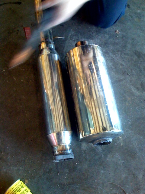

    Ordered parts for the exhaust. The current Hushpower resonators are blown out. They rattle at idle and are LOUD. The LOUD is not as bad as the rattling of the internals at idle.
    Not wanting to pay Hushpower prices only to blow them out again I went with something less expensive. Vibrant Performance resonaters. The fun part was finding 2x 2.25x12. Like no one in the US has them. I even called Vibrant, based in Canada. they said good luck, but if I wait 3 weeks they have more coming. Finally found some at SFX Performance Parts and Auto Accessories in TX. They are now on the way.

    I'm running a Vibrant bottle-type resonator on my Alta Sportone exhaust right now... the larger Alta resonator didn't play nice w/ my B&M Short shift kit. That sucker has held up very well (knock on wood) and still looks solid after over 3 years of cruising way too close to the road surface.

    Looks like I've got a smaller diameter version of your 18" resonator. It's been great and gives plenty of clearance.
    Here's a pic from a long while ago when they were welding up the Vibrant to the Alta kit (Alta resonator on the right).
    PS: That is the floor of the shop that will not be named. :D

    I've melted the perforated core of two Vibrant resonators.

    My exhaust was VERY loud, so in conjunction with my Alta stuff I added a glass pack, installed it backwards, so it does not restrict as much. Sounds great and seems to be holding up well?
