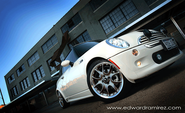

    This pic was taken with the springs and stock struts, if you want an idea of drop:
