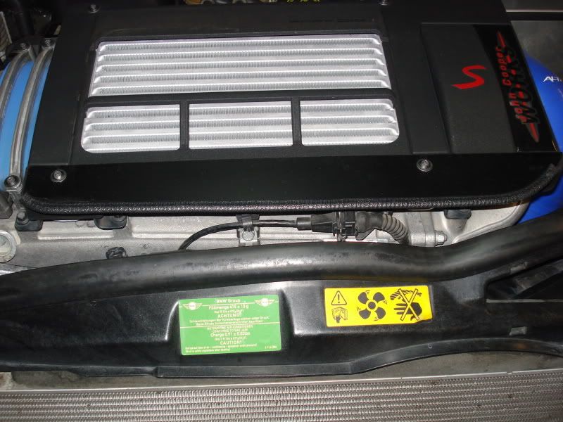

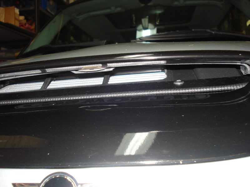

    I am not Matt :lol: But yes I think it will. Once you get to the point your at, BV head, Header.....ect...the money spent on an IC is now a good idea. I also have a BVH, header, tune, cam and I just fitted a GP IC to my car and it seems to be doing a better job than the stocker. Mike from Mynes has published results from the GP IC and it always does a good job :Thumbsup: Here are a couple of pics from my recent install.

    What is that little extension lip along the front edge?
    Also, did you notice a drop in peak boost with the GP IC?

    I made that to close up the gap between the stock IC diverter plate and my M7 Ramair scoop. It was a 2" gap and now it is a 1/4" gap.
    I didn't notice a drop in boost. I have a mechanical boost gauge and it's kinda tough to see exactly what it's doing, I have seen 16psi on it. I do have a scangauge hooked up, but never have configured the readings on it. Mike might know? Maybe he will chime in?

    Ok, got it on the lip. Good job in an OEM looking mod. :Thumbsup:
    The GP IC looks awesome, and has always been on my wishlist.
