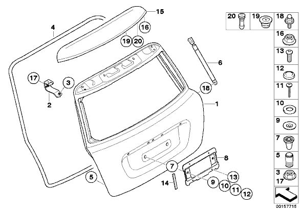

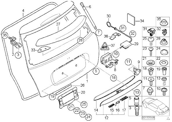

  7. Justa Jim
    Thanks, that would figure. :cryin: In Nathan's pictures it looked like they might have been attaching the uprights directly to the existing spoiler, but I coud be wrong.
    A hatch is not a hatch in this case.
    On the R56 the spoiler is a part of the hatch that if was not there you would see inside the hatch.
    R56 Hatch diagram
    R50/53 Hatch Diagram
    Note that on the R56 diagram item #15 is a compete exterior panel that covers the opening. While on the R50/53 diagram the item #27 attaches to the exterior panel.
    They are not at all interchangeable.
