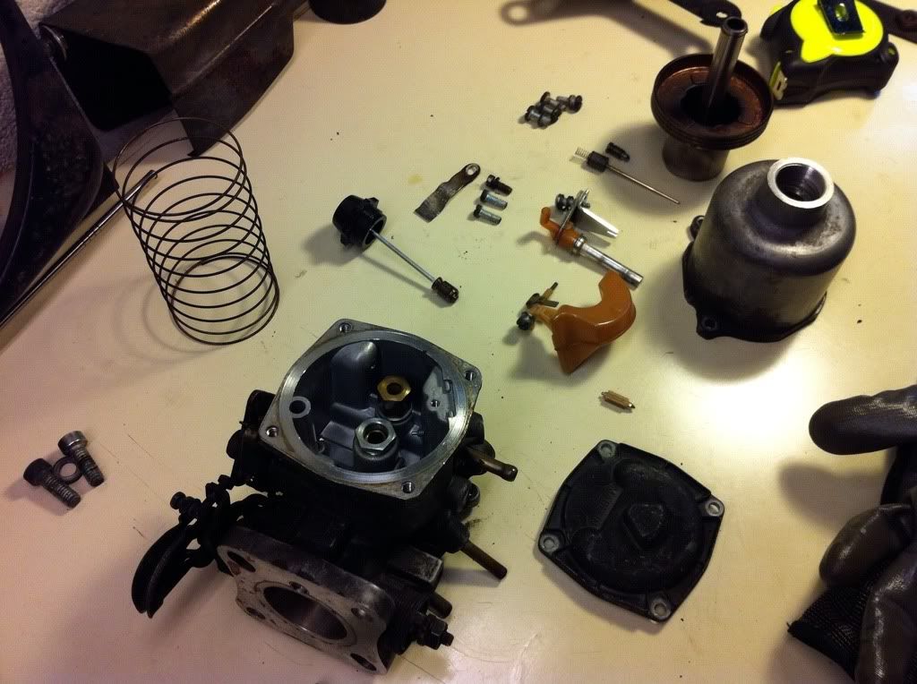

    Carb disassembled! Actually there are less parts than I expected...

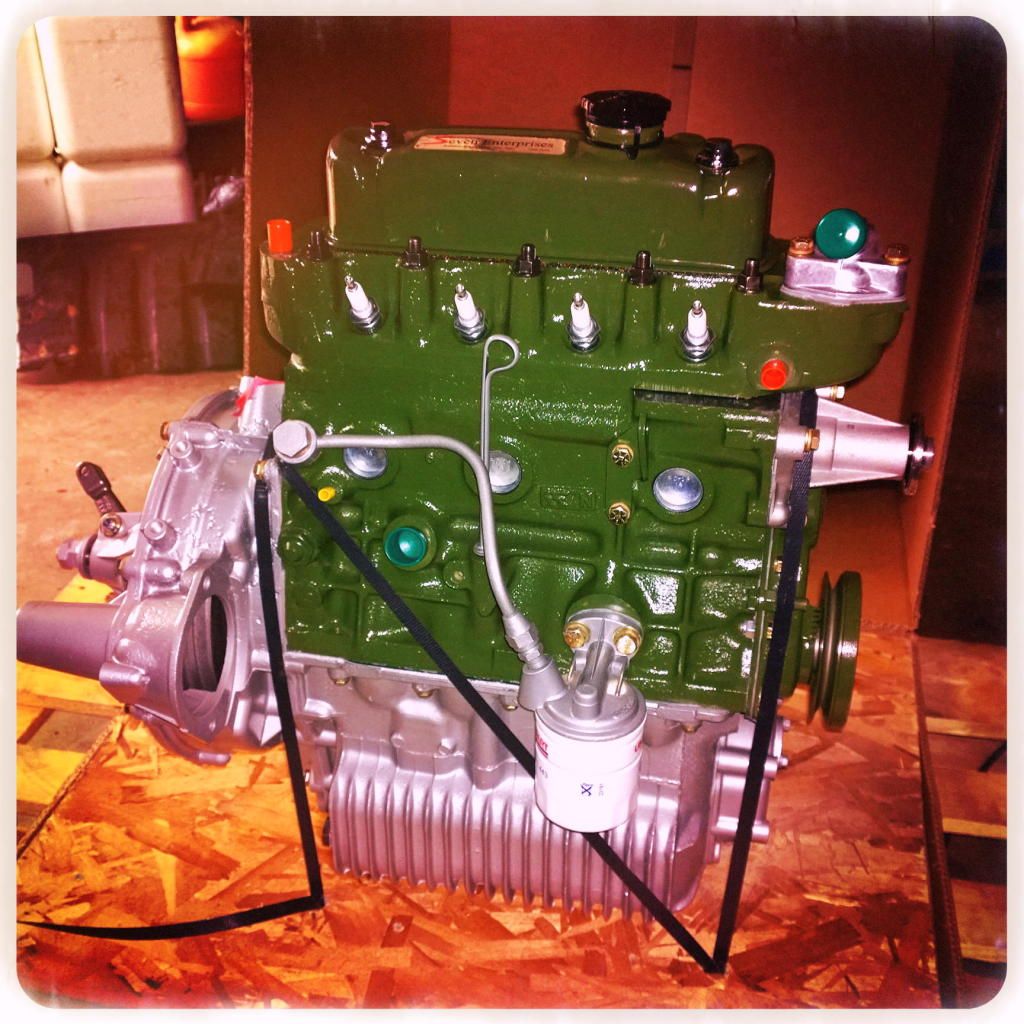

    In the end, the engine needed to be completely re-bored and rebuilt with larger pistons - I had no compression in the #3 cylinder (filled the cylinders with oil and one was empty within 2-3 hours... ugh). Took several months to complete the work, then, just before I was due to pick it up the garage caught fire and the engine was MELTED along with several irreplaceable cars including a Bug Eye Sprite and several racing engines. :eek6:

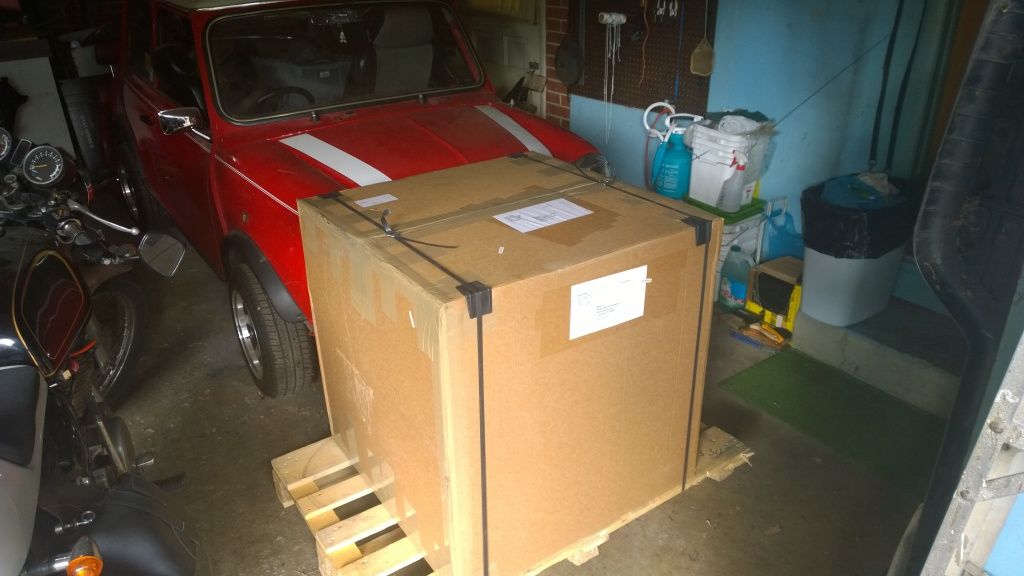

    Insurance covered part of the replacement cost for a new engine, which was ordered from Seven. Cost... well... let's just say quality don't come cheap and leave it at that. In the end , I decided on a slightly-overbored 1275 engine with a split-pin diff, but basically all the rest was late-model carbureted stock. I'm told by Seven that the new powerplant should make something like 75 HP all told, lots better than my stock 50-ish HP (((crossing fingers))).
    Here's the box it arrived in, just before the July 4th holiday:
    Unpacked (oooooooohhhhhhh.... aaaaaahhhhhhhhh.....) :drool:

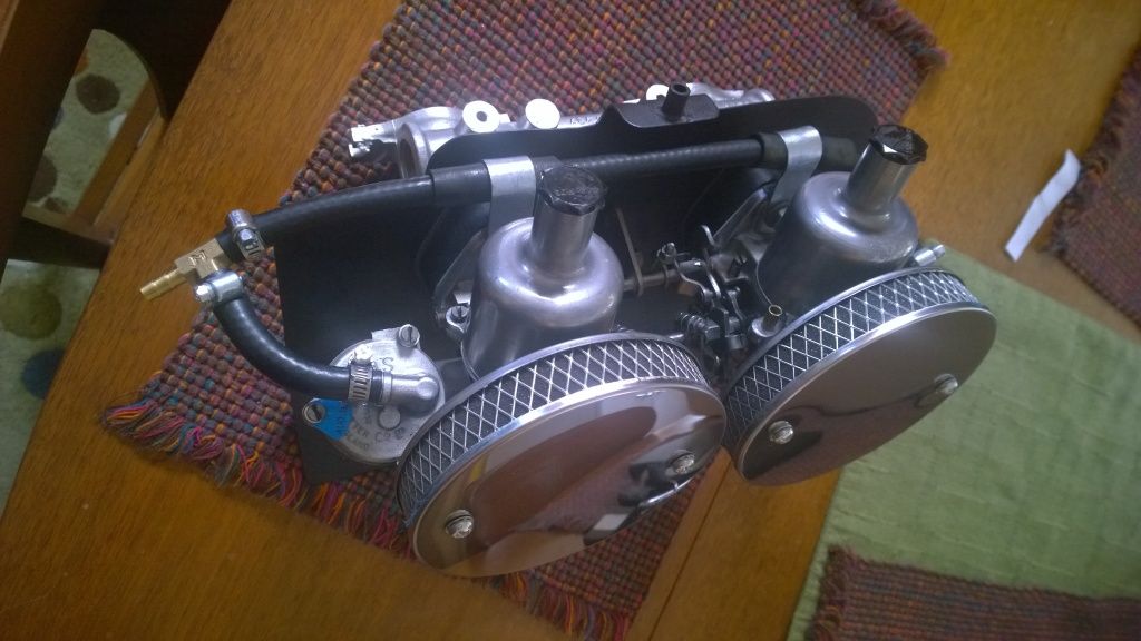

    New carbs supplied by the garage - a cool-looking dual setup I'm told came off a Cooper S:

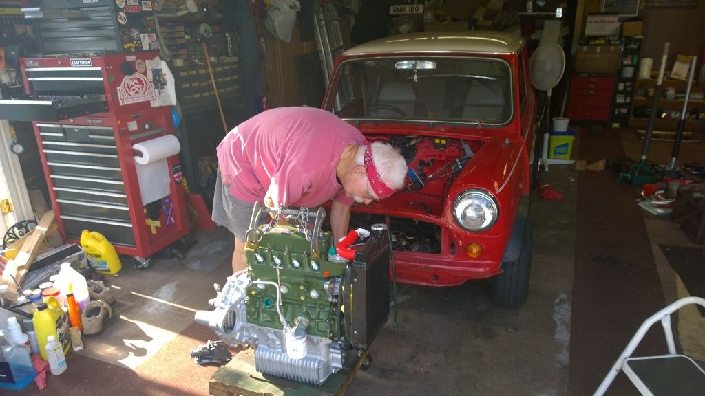

    Engine ready to be installed (thanks a million to Paul and Jason for getting it ready and lending me your extensive knowledge and sweat!!!):

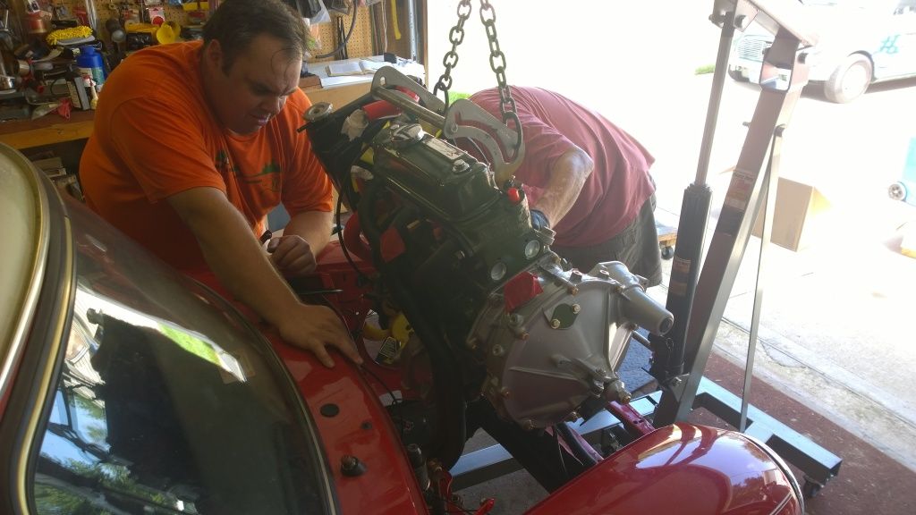

    Checking to see if the drive shafts will clear (they did):
    Shiny new engine installed in Fiona's bay - check out that massive engine steady on the thermostat housing!:
    Unfortunately some critical components, including the clutch connecting rod and clevis pin, as well as some of the engine steady stuff, was left on the original motor and is now slag someplace.
