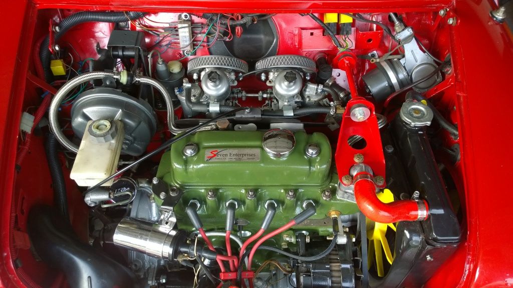

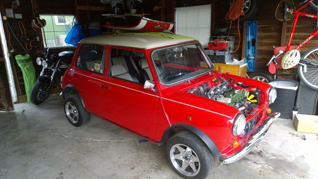

    I'm SO CLOSE!
    She's finally back on her wheels, all major components are installed, and I'm ready for an ignition test. I would have on Sunday, but I ran out of daylight:
    Engine is all put together, minus the wiring for my accessories (driving lights and tach, which I want to re-sort and tidy) - check out those Cooper S carbs and braided stainless lines:
    The cabin needs some love - after much internal debate I pulled out the padded lower dash rail to expose the painted metal lower (which I like the look of). I need to fabricate something to hide the exposed switches on the late-model switchplate, but that shouldn't be hard. I'm considering removing the padded upper dash as well.
    Of all the things I've done so far, the closest I came to having my spirit broken was THIS SUNDAY, trying to hook up the clutch pedal to the master clutch cylinder push bracket - ARRRGHH!! It was SO %$#@!! TIGHT IN THERE! My hand looks like hamburger... :( Finally got it hooked up after much cursing and gnashing of teeth, and it worked right out of the gates - woohoo!!
    Still to do:
    * Fill and bleed brakes
    * Prime oil pump
    * Re-install battery (with extinguisher on-hand, just in case a wire(s) got crossed while I was messing with everything)
    * TRY STARTING
    * Replace brake switch on pedal (somehow I broke the old one)
    * Purchase lower engine steady bracket and install steady
    * Adjust hi-los
    * Fix accessory electricals (tach and driving lights)
    * Wire up manual switch for accessory cooling fan

  13. ImagoX
    ImagoX New Member
    Nov 1, 2010
    356
    104
    +104 / 0 / -0
    SHE LIVES!!!!!!!!!!!!!!!
    Managed to get gas to the pump but then the pump started leaking like a sieve. ARGH!!! Rather than order a replacement and wait another week, I bought a $45 electric pump from AutoZone and hooked that up instead. Now I have plenty of fuel into the carbs. She fired up (roughly) on the 3rd crank, and started to smooth out after running for a few minutes at idle.
    Something was smoking pretty bad on the rear of the engine when she warmed up, but then stopped - I think it may have been an impurity or something on the exhaust header, which I painted with high-temp BBQ paint months ago. Wish me luck with that (although at this point I'm getting pretty fast at pulling the carbs off the manifold). :)
    I still need to fill and bleed the brakes but this is a HUGE MILESTONE for me - the first time the car has run since I took the head off Gawd-only-knows how many months ago... :cornut:
    Since I don't have a timing light or any experience with adjusting the carbs, I'm considering taking the car up to Northend Wrench (a trusted local garage that works on vintage vehicles and MINIs) for a full look-over, tune/timing, etc. My "krew" that helped with the re-install (did MOST OF the re-install if I'm honest) was made up of seasoned veterans, but God only knows how I may have effed things up since they took their hands off it.
    There's light at the end of the tunnel!!!

  20. ImagoX
    ImagoX New Member
    Nov 1, 2010
    356
    104
    +104 / 0 / -0
    WOOOOOOHOOOOOO!!!!!!
    Still needs timed and tuned, but Fiona officially can move under her own steam! Thanks everyone!!
