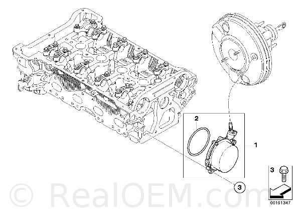

    Hello:
    Does anybody know what this hose connection is for? When the single screw is removed and the part is removed, there is a little valve which is similar to a PCV (Positive Crankcase Ventilation) valve. This connection is at the top of the head and goes to a connection hose which goes through the firewall. I assume it is a vacuum connection of some kind.
    Any help is greatly appreciated.
    Thank you

    Yup....
    That is the connector for the brake booster vacuum tubing (ridged black plastic tubing). It's attached to the brake booster vacuum pump. You don't want to go racin with that line disconnected or you'll end up in the weeds.......:frown2:
    No. Description Supplement Qty From Up To Part Number Price Notes
    01 VACUUM PUMP 1 11667556919 $413.98
    02 O-ring 56 X 2,75MM 1 11667566483 $3.62
    03 Collar screw M6X25 2 11427527412 $1.07

    Thank you very much for this.
    Yes, I should have included some vehicle information. This is a 2010 Clubman Cooper S.
    Metalman, where did you get this picture from, the new Bentley manual?
    Thanks again, that was a big help.
    Regards
    Attie
    The image is from RealOEM A really good site for checking on parts and often assemblies. You put in the last 7 characters of your VIN and all the stuff for your is there.
