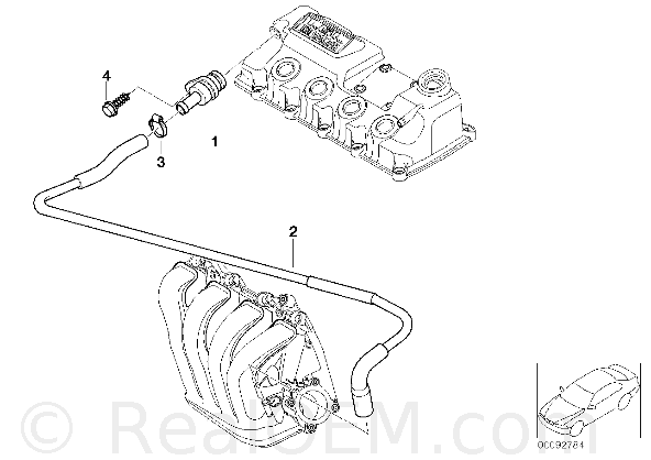

    Oxyblue, I know this is for second Gen's but you said you had done it on your R53 as well? You just add it to the gray line under the IC?? That line runs from the PCV valve to the intake manifold? or to the supercharger inlet tube?? I always thought it went to the supercharger inlet tube. I've got a can of it and a can of deep creep to clean out the throttle body, so I'm just trying to confirm where to add it to.

    anybody got any ideas?? is it safe to run the seafoam through the supercharger vanes?? I know this is 2nd gen but I saw it come up so that's why I'm asking
    thanks
    Steve
  20. skippydog
    skippydog New Member
    55
    I personally wouldnt. I dont know if it would actually harm anything but going post would be the best way in my opinion.
