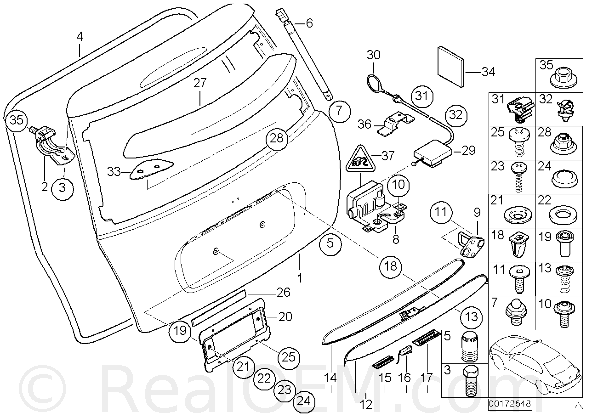

    Ok...so today was a gorgeous day. I gave Schultze a much needed bath and then decided it was time to swap out the OEM 3rd Brake Light for an LED 3rd Brake Light and install my Brake Light Pulsar at the same time.
    Read the instructions many times and had all tools necessary.
    Pulled out the Bentley...just in case.
    Removed the three screws which hold the brake light in place and I was ready to pop out the brake light unit when everything came to a screeching halt.
    I cannot remove my brake light unit because of my Cooper spoiler.
    Aha...I have my Bentley manual right here...let's read up on how to remove the spoiler.
    I was able to remove the rubber plugs which cover the spoiler screws...no problem.
    I don't have a tool that will unscrew the spoiler screws! The groove in the screws (visualize traditional flat-head screwdriver) is small...I'm talking 1/8" if not smaller.
    So I stop and read the Bentley instructions again.
    Damn.
    Not only is the spoiler screwed in place with impossible-to-remove screws, but apparently adhesive is also used.
    F.M.L.
    So...now what?
    If anyone has any tips, tricks or advice, I'd be very appreciative...otherwise, it looks like a might need a special session with Way at MOTD to get this installed.

    We had the same problem with Gromie, even tried wiring it into the harness in the boot. Which had the unpleasant result in having the auto lock, lock me in the car !?!?! We put it on the clubby, much easier :)
    Since you have a Bentley manual I assume this is a first gen car and I'm also guessing it's a Justa..
    A small aside here, this is where it would really help if you created a Garage, any of us could quickly see the year and model...
    Anyway...
    Given the above, this is what you are looking at...
    The spoiler has studs in it with a nut in the body of the hatch as a fastener. You don't remove the stud but unbolt the nut. I think it is 12mm.
    Once those have been removed take some fishing line and pull that under the base of the wing. It will take time to do, and don't forget there is a stud in there too you have to work around.
    No need to replace the adhesive, it will stick again.

    I found the most awesome fishing line to do this :cornut: This stuff is great, has the diameter of 15lb.,test, but the strength of 65lb. line, plus it braided, acts like a saw blade. Cuts through it like butter :cornut:

    Confused. I watched Dan of Grassroots Garage install mine and he didn't touch the spoiler. There is a panel at the top of the back window. He removed that and installed it. I have a R56 MCS.

    :cornut:R56 is 2nd generation and much easier. Pop off a panel, top driver's side inside of boot hatch. Cut and rewire, making sure of neg to neg and pos to pos. Tape well.Panel back on and ready to go.:Thumbsup:Alas I have to get another pulsar as mine has burned out after 2yrs.:(

    When I did my first car I pulled out the rubber cover on the car side that shields the wiring harness going to the boot. Identified the wires and with the help of an assistant pressed the brakes and verified that I had the correct wires spiced in the circuit to the harness putting the small piece of wire on the light side to give enough slack to place the circuit inside attached to the roof after I had verified that it worked. Much easier then trying to remove the wing to remove the light on a Cooper.

    I have an R50 with a pulsar and I just rattled the 3rd brake light back and forth and pushed and shoved and eventually got it to line up just right so it came out without taking the spoiler off, it was a bit scary as the first time it felt like it might break but it is quite sturdy. It was a pain and I had to do it again to put in the OEM clear 3rd brake light! Almost makes me want to get a different spoiler....
