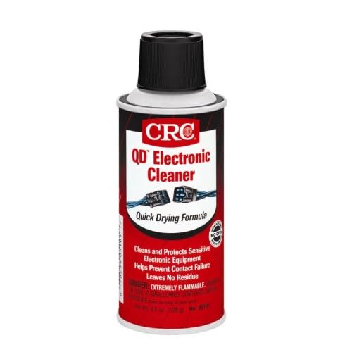

I've tried cleaning the connector already with some electronics cleaner I had laying around (called deoxIT) perhaps it wasn't good enough? any recommendations on a contact cleaner?

BThayer23 Well-Known Member
![[IMG]](http://ecx.images-amazon.com/images/I/41ZDRIzNu8L._SS500_.jpg)

Guess ill try some of that cleaner.... Do you think the TPS issues is adding to the yo yo?
