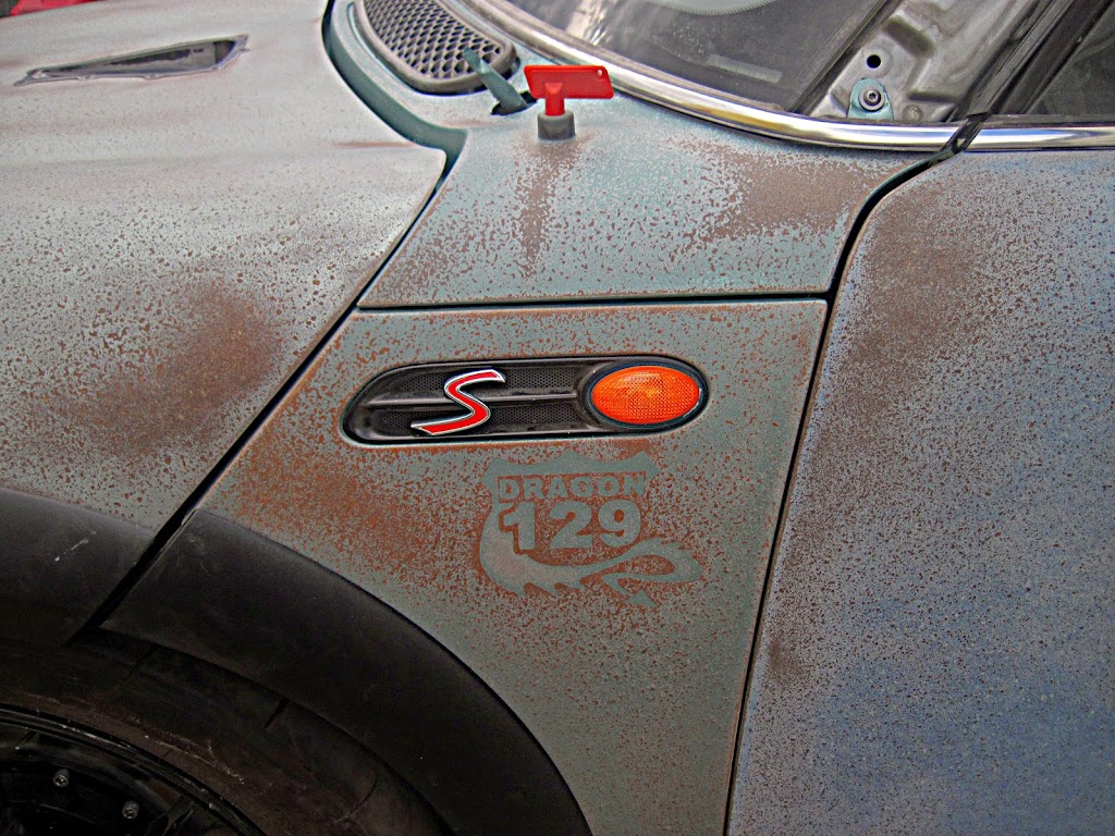

    I decided on my weekend project... It includes some paint...
    And so far I got the first two window decals done...
    #1...
    And #2...
    :beer

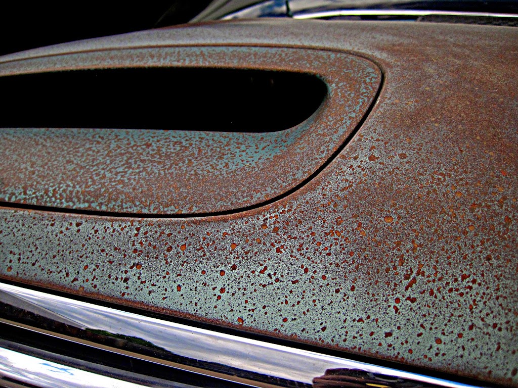

    So here was todays project: Valve cover painting...
    I wanted it to look like an aluminum cover with the paint rotting off, but the cover is plastic! Nothing I cant handle...:wink:
    So now it's aluminum?
    And I said "Let there be Spice Orange!" Then it was, but rather quickly the orange started to fall off! (With the help of a little sand paper)
    All said and done, the clear went on... NO FLATTENER! I want this shiny!:drool
    No it's not perfectly smooth, but I didn't want smooth... To me it looks as good or better than the rust! Now it's back to polishing for me.:beer

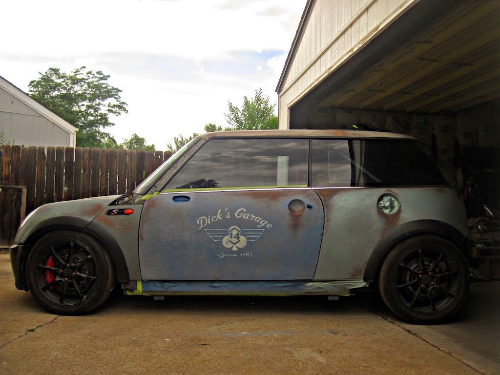

    I have been thinking about making some of the popular old hot rod sponsor decals new again.
    Keeping with the whole rusty old speed shop car theme, it fits having the decals on the rear side glass. Cant have old parts manufacturer logos on a modern car they don't make parts for, so why not make the new shop/manufacturer logos look like the ones from the hot rod age?
    I played around with the idea a bit, and actually really like the one I started drafting up! :)
    There will be a few more that I will have to redesign but heres the first prototype logo... :D

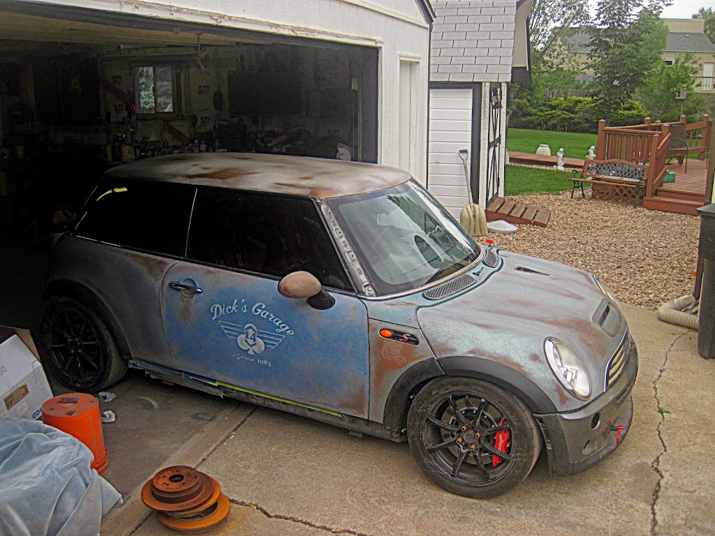

  19. TheModFather
    Meanwhile...
    Still rusting away... ;)
