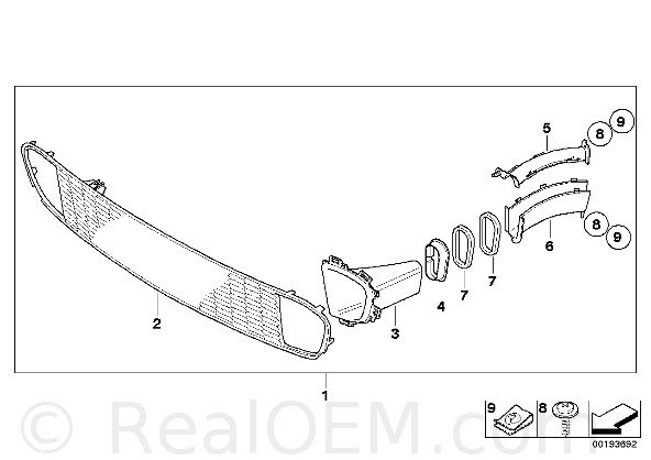

    Would this fit in the stock bumper? The dimensions I've seen seem right, though the parts guy at Morristown Mini seemed to think this would be too tall for the stock bumper. The width is the same, though.
    I see Way Motor Works is selling a kit, but the details are sparse and I can't seem to get an email response from him.
    RealOEM even lists it as a part for the R56 non-JCW, though I suppose that's because you can get the Aero Kit (II) for it...
    Part Number 51192153998 in RealOEM

    There are (were?) two R56 JCW Aero Kits. At the following link, if you scroll down, you can see that there is a JCW AERODYNAMIC PACKAGE and a JCW AERODYNAMIC PACKAGE II.
    RealOEM.com * Diagram Selection
  17. Metalman
    12,732
    7,689
    +7,961 / 1 / -0
    So the presumption is the brake duct grill from the first generation JCW bumper would fit the current stock bumper....... Interesting.
    And the brake duct grill for the JCW bumper II is unique onto itself...... Definitely
