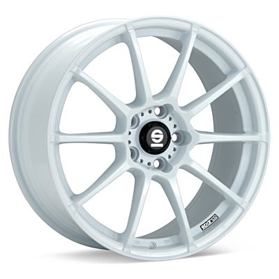

    I knew from the day I saw it that she would rock some Assetto Garas which I still have to this day.
    They have incurred some rash unfortunately but not too terrible!
